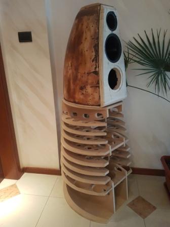

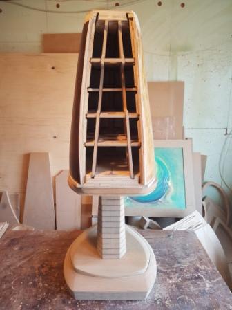

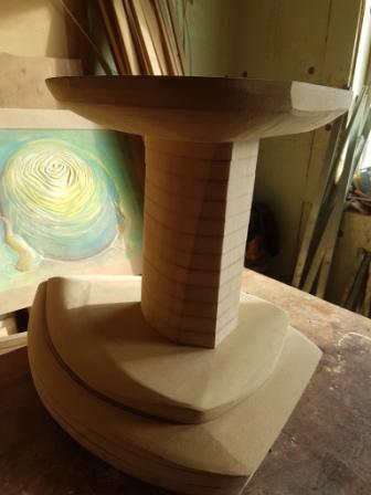

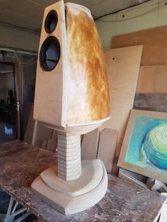

Mislim da je vrijeme da vam pokazati projekt za stražnjim zvučnicima;
Zvučnici su "SEAS" - Excel T25CF002-1 ", W18EX001-6,5"
Sve je ručno, nema stroja "CNC".

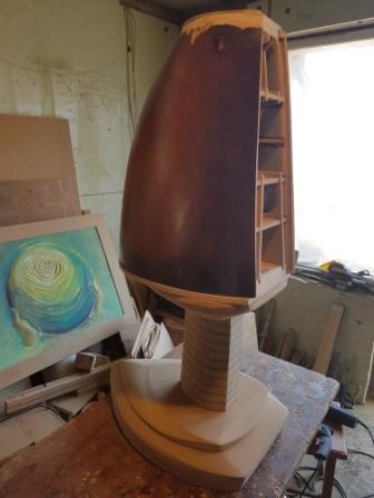

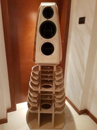

I have an idea to make a new project to in the base there should be two 10" loudspeakers - just an idea. They look like animals, maybe dinosaurs, but important are 20Hz.

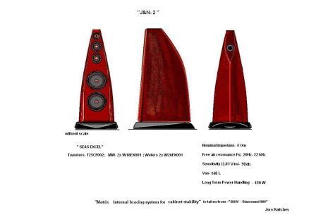

And the original model will look like this;

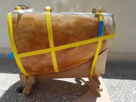

PostPostao/la jororaitchev » 09 lis 2017, 13:36

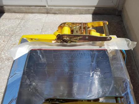

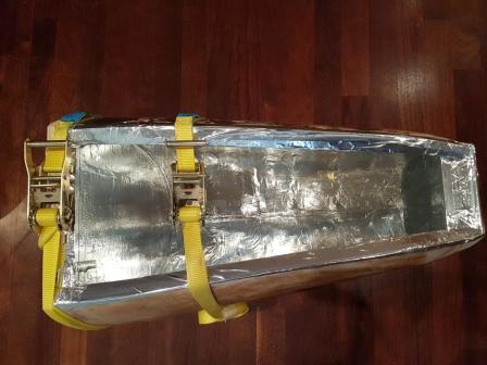

I am approaching to the measurement of the internal volume:
cs ko.jpg (31.08 KiB) Pogledano 21579 put/a.
On the last picture,the red line is the waterline
, the vas of cabinet must be fill with water next to it / everything must be perfectly horizontally!/.
I measure the weight of the my vented inner construction - 3.5 kg.
-The amount of water is 42 l. in the box; 42-3,5= 38,5l, 4.5 l more than what's needed - what's next?
The problem is that my investor likes the vision of the column.The decrease in volume must occur inside the construction of the cabinet.This sends the project in a more initial phase,we have a new requirement for the project, another W18 EX001.
Let's assume that the density of MDF is 0.75 kg. of cubic decimeter/ average value by tables /. This is 75% of the actual reduced volume.
The reduced volume error is:
3.5 / 0.75 = 4.6 liters actual reduced volume, and the whole volume is 43-4.6 = 38.4 liters.
The total error of 39.6 liters is 1.2 liters or -3.1%.

PostPostao/la Rade » 13 pro 2017, 10:11
kako računaš zapreminu kutije kad koristiš matrix . Meni se čini da su ti proračuni komplikovani jer matirx ima tendeciju da povećava zapreminu viđenu od zvučnika .
Rade
Postovi: 216
Re: A few my DIY projects "J&N"
PostPostao/la jororaitchev » 16 pro 2017, 21:56
Rade je napisao/la:kako računaš zapreminu kutije kad koristiš matrix . Meni se čini da su ti proračuni komplikovani jer matirx ima tendeciju da povećava zapreminu viđenu od zvučnika .
Nisam siguran da razumijem vaše pitanje.
U svom projektu pokazujem kako izračunavam volumen složenog tijela, bez obzira na veličinu. S pravim oblicima velikih stupaca, sve se svodi na jednostavnu geometriju i matematiku.Ne vidim problem ako napravite neki unutarnji rebrasti kabinet,
u pravim oblicima ne postoji problem za točan obračun - možda postoji jezična barijera, ako možete postaviti pitanje na engleskom jeziku / bolje u bugarskom- vic!/

PostPostao/la zbotic » 19 pro 2017, 21:35
I think that he want to tell you that is not the same if you have matrix box or simply volume. Maybe he have a right because dynamicaly air pressure is not the same in both situation especialy if you have big speaker volume. There is a situation with turbulent air flow in matrix box.

PostPostao/la jororaitchev » 07 sij 2018, 15:34
zbotic je napisao/la:I think that he want to tell you that is not the same if you have matrix box or simply volume. Maybe he have a right because dynamicaly air pressure is not the same in both situation especialy if you have big speaker volume. There is a situation with turbulent air flow in matrix box.

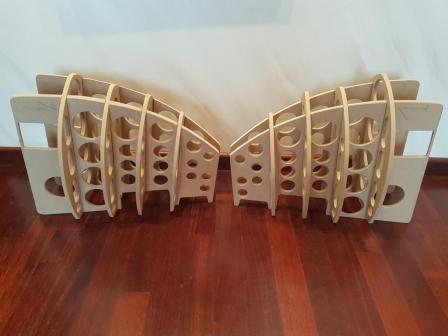

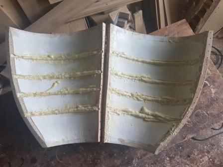

That is exactly the case, but there is a particular situation.
In the construction of my cabinets I have chosen matrix ribbing because the meaning of this construction is in three basic aspects;
- Makes the construction of cabinets to bi silent
-Help as in the implementation of a complex construction
-You do not need to use a insulating material / wadding or other damping material/..............
Upravo je to , ali postoji određena situacija.
U izgradnji mojih ormarića izabrao sam matrični rebrenice jer je značenje ove konstrukcije u tri osnovna aspekta;
- Izrađuje ormariće kako bi utihnuo/čini konstrukciju kabineta "tiho", bez vlastitog zvuka/
- Pomaže izgradnji složenih konstrukcija, kao moje proekt.
- Ne treba koristiti izolacijski materijal / vata ili drugi prigušni materijal /
