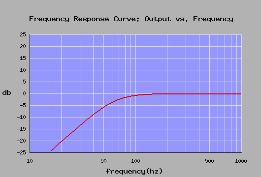

Inače, malo sam vrtio brojke po kalkulatorima i za kompresijsku kutiju sam dobio ovako za slijedeće podatke: Diameter: 21 cm, Qts: 0.523, Vas: 11L
Vb = 13.899409158733 liters
f3 = 64.903610592572 Hz
fb = 64.244741873805 Hz
dbpeak = 0.0018091834542131 db
I frekvencijski odaziv izgleda ovako:
Kompresijska kutija

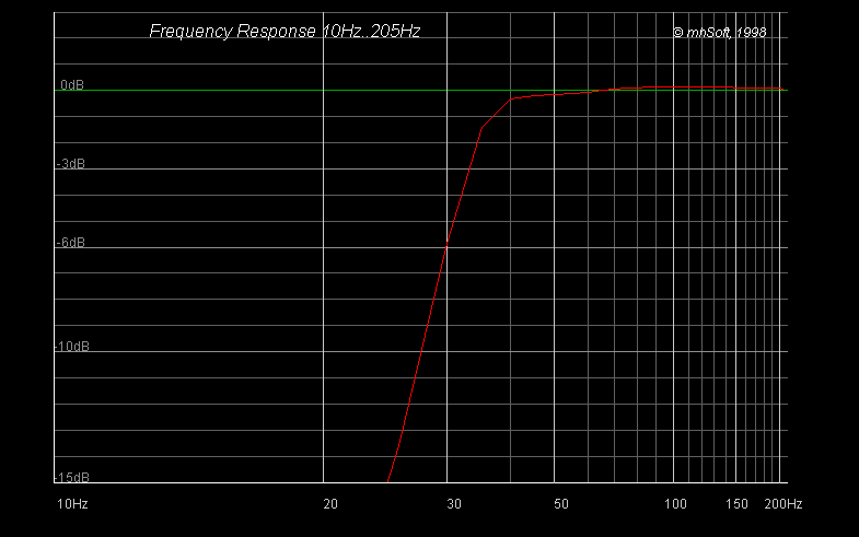

Dok sam za kutiju sa bass reflexom dobio ovako:
Calculated inside Dimensions
Width = 29.5cm
Height = 47.47cm
Depth = 18.23cm
Volume Vb = 25.68L
The bass reflex port should have at least 1/3 of the driver's diameter!
Dp : 10 cm Diameter of port(s) - you may change the port diameter <- to sam manualno podesio na 10cm, mislim da bi ovaj bass reflex bio dobar http://www.dobar-zvuk.hr/hi-fi/pribor/bas_reflex_100.htm
Port area = 78.54cm2
Port length(s) = 61.31cm
Calculated Performance Specifications
Fb =3 6.59Hz Port alignment frequency
Peak = 0.092db Peak level
F-3 = 31.42Hz "Cut-off" frequency at -3db
